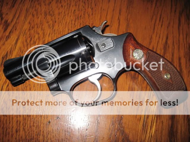

Early "J"-Frame
By serial number 19,000 (circa 1952) or so the now familiar "J" frame has emerged.
While still a 5-screw frame, this early J shows off the hallmark design features that would be prominent for more than 30 years in subsequent production. Note the lengthened grip frame and stocks. (A hint.... count the number of checkering lines below the "Diamond"). Also now standard are an enlarged Trigger Guard and Ramp Front Sight. An improvement over the "Flat Latch" Cylinder Release, this so called "Ramp" or "Burr" Latch will remain common and intermittent through the 1960's on some derivatives of the J-Frame, particularly the lighter weight Model 37's, etc.
