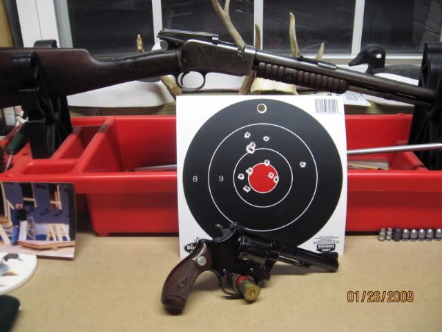

this post got me to haul mine out,, just shooting tonight in the basement (aguila .22 super colibri's..and i NEED to get more ) dime size groups at 40 feet offhand..
sure beats hanging on a wall...
