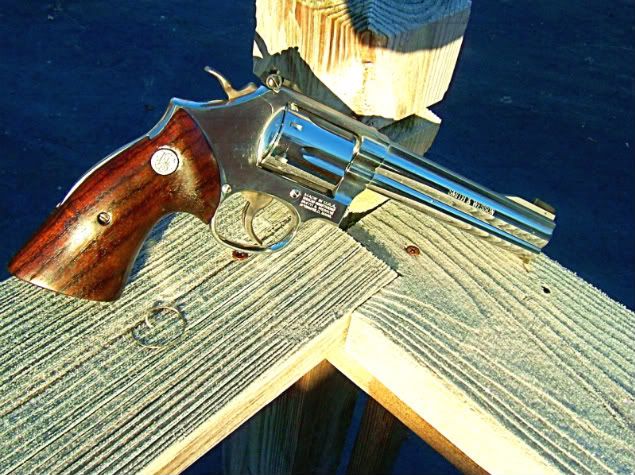

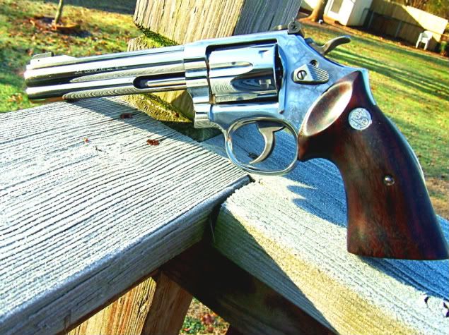

Sadly, Today Like all others things made in the United States anymore, most are Rushed and not Finished to the High level or Eye Appeal we learned to love on the S&W classic K-22 offerings. Soon after getting this revolver home, I took it Down to the bare frame to Polish the Internal action Pieces, and finish Polishing the Internal Part's. I quickly Noticed that The main Part of the frame where the rebound slide comes in Contact, was not finished square and most of the rebound slide assembly did not come in complete contact with it as it should, so I stoned the rebound slide, Then Polished the surfaces with 2000 Grit 3-M Wet or Dry sand paper. That improved the smoothness of the action and made the world of difference in the action's Performance. I then was not in Love with the drab looking factory finish so I used Mother's Mag wheel Polish and a soft towel to improve the appearance of it some. Below is a series of pictures that show it before it was Polished, and while apart....By the Way, I Like Your Handle. Now, "That is Funny I don't care who Ya Are"... Hammerdown

I seen where you posted in the other site I was at and the handle hammer down was used. I thought, I wonder if thats same one that comes in here.Once I seen this post and pics I knew it was one and the same.You got the gun looking like a nickle finish came out perfect.And the grips make it a totaly different very appealing gun.
I didnt realize the newer smith and wessons needed the mechanisms polished up.The only modern one I have shot was a 4 inch 686 before the lock version six shot.
The guy that had it died before I ever met him but he tinkered around a lot with his guns. The one I shot was pretty smooth with a nice trigger pull like a older one.He may have did what you did.With the four inch barrel it was well balanced and I liked the gun. I imagine the six inch barrel would not have the same balance though.

Beautiful work on the revolver and the Eagle Cokes! S&W should take notice on how fine the combination looks! IMO, full-size target stocks look sort of oversized on a M-17, but they look perfect on your 617 - must be the long underlug that balances things out.

When I swapped into this revolver late fall of this year, it came with it's standard issue factory "Good-Year's" I suppose Rubber grips are fine on Big Bore Magnum style hand Guns for Recoil Purposes, but to me Not on a .22 Revolver.. :roll: Being that the New Generation 617's are of Round Butt Configuration it Post's a Bit of a Problem finding wood larger style target grips. I Can't be certain who is Making the Wood Grip's for S&W Now, but I as Unable to find any Smooth Coke Profile grips for this revolver. Keith Brown Makes some Dynamite Looking wood Grips in a round Butt conversion, But his waiting list is Long. The Only other Option in real wood grips out there that I could find was Karl Nill Grips from Germany.
He makes some Fantastic Coke Profile checkered grip's But again, Nothing in a smooth style Target grip. I chose to go with a set of Eagle brand Grips and called them to place my Order. I stressed when ordering them, that I wanted Book grain Matched wood, so they assured me the set I Ordered would be hand selected for High grain definition and Book grain Match. I received them a few days after ordering them, and was Not Impressed with their fit or finish. They Looked Orange in Color to me, and The Coke Profile Palm Swell only appeared on the right hand grip Panel. I called them and asked why the Profile was only on one panel and why they fell short of meeting the back strap along with what I call the Upper wing area, and they told me that Not all S&W revolver frames run the same size. That was a new one on me as i thought S&W Frame sizes were standardized back in the late 1950 time span ?
I Think Eagle Grips are made in Brazil and sent to The United States as a finished Product to sell, as they are stamped on the Rear Brazil and I was told that the wood was Brazilian Rosewood. They were Nice enough when I called them about the fit and Finish Issues that Bothered me, But I felt if I sent them Back, I may end up with Ones that either fit worse or did Not match in grain, so I shaped Both Panels to have a Well Pronounced Palm swell that fit my hand, and dropped the Overall Thickness of them. I then shaped the bottom's with a more Oval shape as the Original Coke's had and Placed a slight Bell shape to them. I chose a set of Pre-War Factory emblems as these grips are of Larger profile, and set them into The wood by using a 13/32" Mill End Bit on my Drill press. I them sanded them down smooth and applied an Arrow wood finish to them.
Arrow finish is applied by sanding it as you go with different grades of sand paper starting out with 320, Then 400, 600, 800, 1000, 1500 and finishing up with 2000 Grit, This finish Places a Urethane Semi Gloss finish very similar to the Original Coke profile Factory finish and as you sand it in, it fills the grain and wood Pores to Bring out the maximum wood grain definition. To me, They Now Look Decent but someday I want to order a set of Karl Nill Coke Profile grips as shown and the Link provided below. His Price is Not all that Bad considering the cost of everything else today. Regards, Hammerdown
