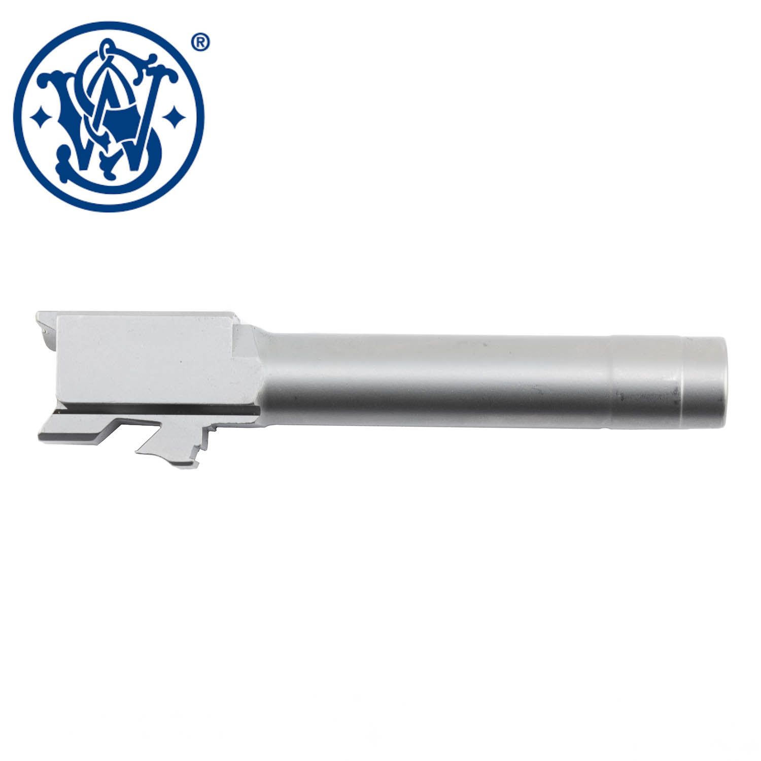

In any case, S&W is likely our only source for this replacement barrel. I would contact them in any case about inspecting the firearm under warranty if the ammunition you were firing was new manufactured.
These people list the barrel:
