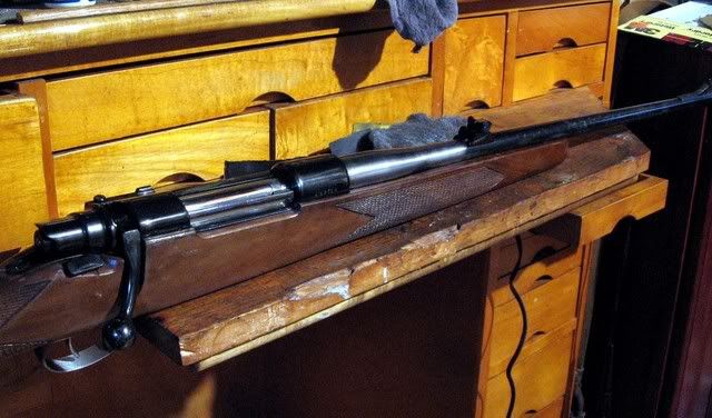

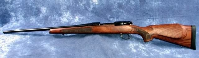

Plans change I was going to go through this Interarms Mauser. And turn it into a custom rifle. I'm still going to fix it up. Just not going top shelf with it. I like to turn Mausers into custom rifles. With the Interarms it's just not a Mauser to dump a lot of cash into. I would much rather do up a 1909 Argintine Mauser. Here is where I'm at now. I picked a a new stock from a Remington 798 which is the same basic Mauser. It's a laminated stock no big deal for a spare rifle. I will put the Interarms in the Remington stock. I will refinish the rifle with a satin blue finish. I polished the bolt and bolt sleeve. I will leave that high polished. For a chrome look. It should turn into a fairly nice rifle. I was going to swap out the side slide safety to a true Mauser one. Another cost issue. A nice three way swing safety is about $230 Plus a new trigger group. I would be looking at $350 for that. That is just the parts & doing the work myself. And in the end it will still be an Interarms. I'll save those goodies for a 1909 Mauser. The first pic shows the barrel was rusted and pitted that is fixed. The second picture is where I'm at now waiting on the new stock. The last pic is a picture of the Remington stock that I will use. The rifle will look close to the last picture. With the exception of a satin finish. With a set of of necg custom sights. After I fit the rifle to the new stock. If I'm lucky it should just drop in. I will send it off for the blue satin finish. When I'm done with it I'll post a pic of the before and after. I'm not a fan of laminated stocks. But for this one it will be an improvement. Over the stock that is on it now. I have a spare Leupold 3x9 for the rifle and some nice Warne bases & Talley ring. It should all work out and I'll have a spare 30/06.

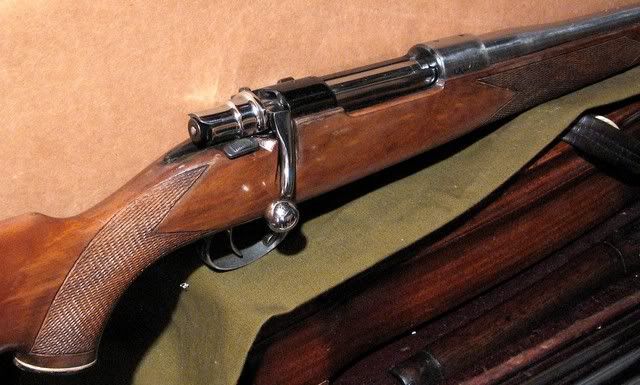

I reworked a previously sporterized P'14 that had been rechambered to .303 ICL Improved by P.O. Ackley back in the late 1950s. The stock was a heavy, garish cherrywood affair with a huge rollover comb and Weatherby style fore arm tip from Herters. I reworked it into a more subdued classic style. Here's the gun next to a M1917 which resembles the P'14 perfectly.
.303 ICL Improved case beside a standard .303 cartridge. One ends up with a rifle that can propel a 150 grain bullet to 3000 fps, in effect a .31-06.
I've built up a couple of 1903s into sporters, leaving them in .30-06 and also built a .375 H&H Magnum on a M1917 action in years gone by. Currently I have two actions squirreled away. One is a 98 Mauser in the VZ 24 variation and the other is a double heat treat Model 1903. I'm thinking of some sort of non magnum 6.5 for the Mauser and a .358 Winchester for the '03.

Nice rifles. I'm still plugging away on the interarms. Plans change again. I dropped the barrel off at the gunsmith. I'm going to have him cut it down to 21". That way I clean up the end of the barrel. I had to cut 3" off. To remove the old sight holes. I will use screw plugs in the rear sight holes. No biggie the deer won't know the barrel is only 21". It should make for a nice (loud) short carry rifle. At least I do not have to worry about a front sight. I'm putting a scope on it. When I'm done I'll post some pix.

Maybe I will be able to shoot the rifle by the weekend. The stock should arrive in a day or two. The barrel work will be done on Friday. The rifle will not be refinished. At least I can bolt it all up. Then test fit everything. On the weekend I will find out how good or bad it shoots. Then I'll take the rifle apart and send it off for a refinish. These Mausers can be made into a nice rifle. This one will be a spare rifle. I have a few 30/06 in other barrel lengths. So I figure a 21" would be nice. Most of my 30/06 are 24 inch. I have a couple in 22". Now I have a 21 inch. It was cheaper to cut and crown the barrel. I had to have three inches cut off the barrel. To clean up the the holes from the old front sight. It had a 24" barrel. Now it's a 21 inch.
Vice new steel sights. I would be looking at $250+ just for some nice sights. It hits a point of no return. In for a penny in for a pound. I want to keep this project a low cost fix up. I'll save the high end stuff for another rifle. I have some others in work. I have some spare sights, stocks and new barrels. I just have to sort things out. When I'm done I'll post a pic.

I'm still plugging away at this mauser. So far so good. The barrel has been cut back to 21" with a new crown. I have it in the new stock. I need to glass bed the recoil lug area. It took a little fitting to get it in the stock. I'm too lazy today to finish it up.

It's getting close for me to send the rifle off to have it blued. I like to save that for the last thing to do. Here's a liitle better pic. The pic shows the shorter barrel and a pic of the new crown. The rifle has a nice balance in hand. It should be fine for beating around the woods.
