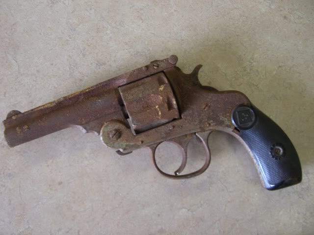

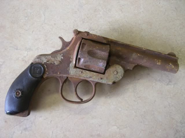

A co-worker friend of mine asked me to see what I could do to "restore" this old pistol. First off... what is it? Next, how to proceed? Navel jelly and brass scrubbing brush? WD40? Your thoughts and recommendations please.... :shock:
hvapa;p; hipnp
It's an Iver-Johnson .32 Centerfire. Probably made in the 1900-1930 time frame.
If it were mine and I needed some therapy, I would soak it in Marvel's Mystery Oil for a week or two then go after it with a brass brush. If you can get the stocks off without fracturing them, it would be a good idea.
When you're done you may have a wall hanger with something of a rough but interesting patina...
I would avoid Navel Jelly... it will strip the metal and once removed you will have a rust ball once again....
Fortunately most of the parts are readily available from Gun Parts Corp. See the schematic: http://www.e-gunparts.com/productschem. ... 20REVOLVER

That there is a Harrington & Richardson.

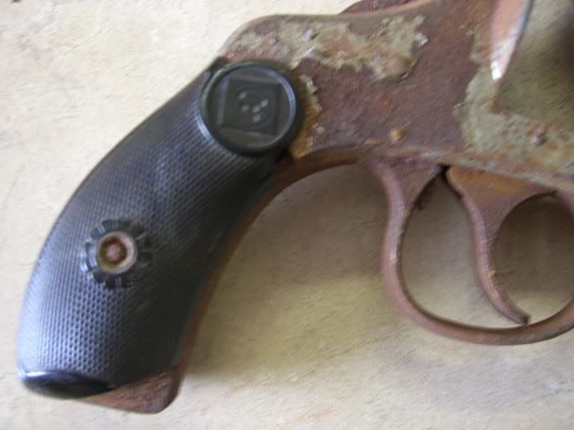

H&R made a five shot .38 and a six shot .32 on the same larger frame and I believe yours is the latter. Compare the following photos:
The target emblem on the grips is Harrington & Richardson's trademark. They also made a hammerless version of their larger frame .38 and they made smaller hammer and hammerless .32 framed breaktop revolvers. They are finely made and finished little bicycle guns that competed with S&W and Iver Johnson (Owls head trademark on the grips and a transfer bar hammer system that was way ahead of its time).
Unfortunately, I must say that in perfect and original condition the H&R's are not very collectible and their value is not very great. I sold an unfired, beautiful pair of .32 and .38 hammerless guns for just $400 for the pair a few years ago.
That poor old gun is beyond refinishing and the rust looks so bad as to be unsafe for any kind of shooting. Hop over to www.GunBroker.com and search Harrington & Richardson and maybe you can buy one for him for around $150 and then tell him you refinished it for him!

All.. Thanks for the replies so far. Now I have a positive I.D. Here's some background, and yes it will be in a shadow box (along with some other items) and not back in the "hole" it came from. This revolver belonged to my friends wife's uncle long ago. Upon his passing her cousin gave it to her. It wasn't in the greatest shape but OK. It was stored away (almost forgotten) in their barn for many years. Apparently the barn leaks, and yes we do get occasional rain in Arizona believe it or not. Anyway, they asked me to clean it up (restore) as best as possible for a display box. The original nickel is pretty much gone. Once the crusty rust is removed and I can see what the base metal condition is like we'll proceed from there. Soon to be a "work in progress". Suggestions for rust cutting and metal treatment still very much welcome... Thanks... ya'll are great jvfmn;o

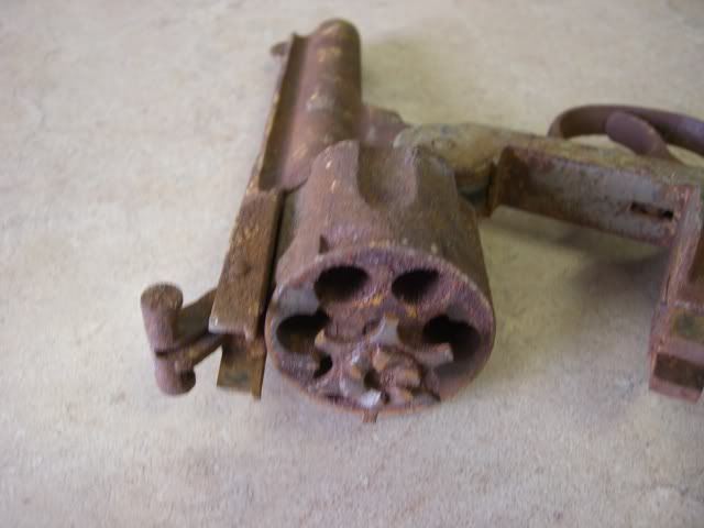

Marvel Mystery Oil soak, 1 1/2 weeks. Rub & scrub w/WD40 & brass bristle brush & brass bore brush. Some light work w/Stainless wire wheel and Dremel. Another day soak in Hoppes #9. So far so good :roll: . Any ideas on removing the remaining stubborn nickel.
