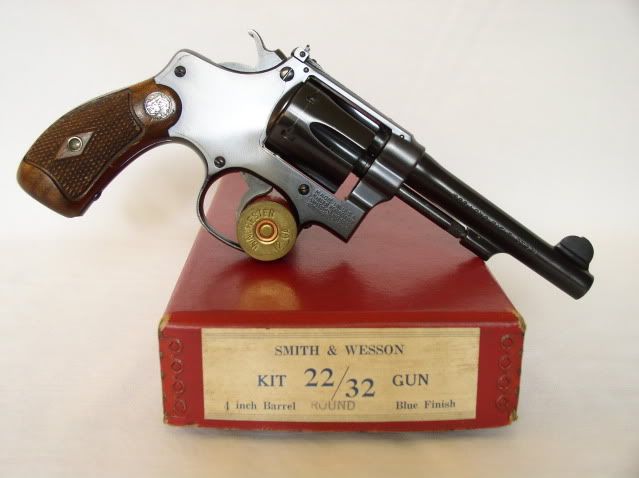

PRE WAR
bright blue finish
sharp cornered borders to checkering
patent dates on barrel
front sight pined to barrel
MADE IN USA on right side of frame
knob on end of extractor rod
flat faced hammer no internal hammer block
1935 gun
TRANSITIOAL
matte blue finish hammer & reboundslide pins polished to frame
rounded corners to checkering borders some will have magna grips
no patent dates on barrel
front sight forged with barrel
4 line adress on right side of frame
no knob on extractor rod
modern type hammer face hammer block working off rebound slide
1952 gun

Let me bring this thread back from retirement so I can show pictures of a Prewar KG from June of 1940 that I stumbled across on the dark bottom shelf of a gun shop in Santa Barbara about two months ago.
Numbers all match, including the stocks. No box, unfortunately. The sideplate had never been off. I opened it up and cleaned out the varnish, which improved the action immensely. I will probably fire this one at some point. There was enough grime around the breech end of the barrel and stuck to the ejector star to show that someone else had, so it is not a completely mint specimen.
This gun, which I would rate at 99% (though a harder grader might put it at 97-98), triggered my interest in .22/32 I-frames in general and Kit Guns in particular. Since then I have bought another Prewar KG, almost as nice as this one, which was shipped two years earlier. The second one has a battered red box and a USRA sight (like the one in the first post on this thread) instead of the more usual Patridge. I will post pictures as soon as I have a chance to take some -- maybe in another five to 10 days.

And this is the other Kit Gun I mentioned earlier: 530553 from March of 1938. As James just mentioned in the previous post, this one came with the original box.
The box is numbered to the gun, and the serial number is consistent on all the numbered parts of the gun -- stocks included. The codes on the bottom of the box are RB-W for "Round Butt-Walnut" and a circled "USRA" for the type of sight.
I can't argue with James about which type of front sight is more common. I know the USRA sight was a factory option, but I think I have seen more Patridge sights than the other kind. Sounds like his experience runs the other way.
This gun is almost but not quite as nice as the first one I posted. The bluing is a little thin on the ejector rod, and contact with the end of the ejector rod has worn the bluing off the back of the ejector locking lug under the barrel. The barrel and chambers are sweet. Everything else looks really nice except for a couple of nicks on the thumb latch. Looks like the cylinder might have been inadvertently swung up while the ejector star was extended. I see no evidence the side plate has ever been off. I'm calling the finish on this gun 95-96%, but I think I may be conservative.
