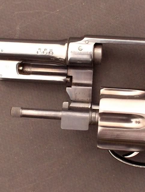

yep , a new one for me,, even has the "lock"... :lol:
the rest isn't so bad either...
a new century, in .455 rechambered to .45ar.. it's been reblued but thats ok,, it's my first triple lock...#50xx and i'm thinking somewhere around 1914 as a date?
now to get some ( half moon's) hpnpap

Now that is a S&W revolver with a lock that I would buy. Congrats! Regards 18DAI.
Nice find, kritter! Congrats!

Very Nice, thats a lock I would mind either

A really nice gun, and I congratulate you on that 'find'.
The star is a factory rework/refinish mark.
