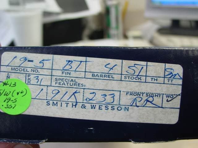

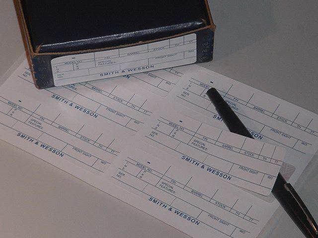

The box thread got me to thinking on how to visually tell when you encounter a phony box label. I got these two pictures off of Gunbroker (and have nothing to do with either), one shows an original label (top picture), and one shows the reproduction (i.e. phony) box labels (bottom picture). As you can see, the original box label has a dashed line just above where is says "front sight" and "wo". The repro labels have a solid line in that position. As was said in the other thread, those who try to pass off a box as original with one of these repro labels, is not being "above board". Buyer beware.
There are other differences, but you're right on Ken... this is one very easy way to spot them....
Those that would 'tag' a Smith box would take their good looking sister to the Class Reunion Dance and pass her off as their fiance..... :roll:

There is a guy making a lot of money selling phony boxes and labels on ebay and gun broker. He claims they are NOS, rumor has it they come from China. He's been driving the Colt collectors nuts for years
