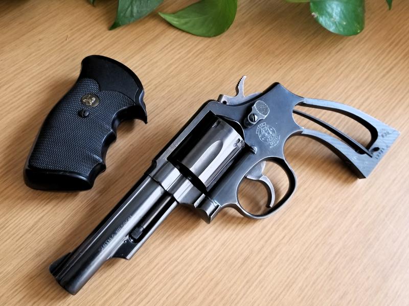

I could use a little help identifying What I believe are Belgian Proof Marks on a S&W Model 19. Thanks to help in another forum I believe I have part of the history of this gun, but not all. I believe that the proof house and the year can be identified from the proof marks, but I would like to confirm that, because it will help to identify the revolver properly.
When acquired the gun, I knew it was, re-imported to the US from Europe fairly recently, but was not sure if it had been modified while there. Here is what I know so far:
  • S&W Model 19-P
  • Fixed sights
  • Slotted, painted front ramp sight (this is what threw me a curve but apparently factory)
  • WISCHO mark on barrel (I know this is or was an importer based in Erlangen, Germany)
  • S/N AWF17xx (according to the SCSW 4 this dates it to ~1987)
After some help I found a note in the SCSW book that mentions a Model-P, and confirms the approx year. Apparently an overrun of a special order, shipped to Europe. Proof marks are NOT German as I first thought, no sign of an Eagle over N or German house marks.
What I still need help with:
  • What looks like a crown over a cursive L in an oval, may be a Belgian mark for foreign firearms. Same mark on bottom of barrel, frame in front of trigger guard, and rear face of cylinder (almost invisible)
  • P over bar on bottom of barrel, a date code (?)
  • Star over a letter on barrel (??)

Yes, and no. You may have seen my other thread in the other forum, as well as my previous one, so you probably know why try to get someone to confirm my not-so-educated guesses about dates and places, LOL.
Pete
23,168 Posts
I haven't seen your other posts. If it was on the Blue Forum and they couldn't help you, I doubt I can. I found this more extensive reference to proof marks: Proof marks | BOBP Application.
I'm no expert but it appears that your last picture of the flame over L is the Belgian standard proof for foreign made guns. The other marks, I can't decipher them.

LOL. That was my thought too, even before I got my hands on it. Funny though, found out in the meantime those were actually the rubber grips the 19-P overrun guns shipped to Europe with... I'm always open to suggestions, is this any better? I have a set of 1980's Target grips I could put on, but these are more streamilined and seem to look better on a 4" gun with fixed sights.

It is one of a special order with fixed-sights for the Peruvian Police, made in 1987. About 3000 were made, only about half were shipped to Peru before the order was cancelled. Most of the rest went to Europe, some stayed in the US. The European distributor was Wischo, so that explains that mark. This one was imported to Europe via Liege, Belgium, and has the Belgian proof mark for foreign firearms, L in a circle with the flame (or crown). The pic below came from another thread in this forum.
The "P" is a Belgian date code for the year it arrived in Europe, 1988.
Still working on the rest.

All you stated is perfect. Even this is a very old post, I can add that the Y under a star indicates the name of the inspector, in this case was Mr François Delsaux
Thank you! Old or not, I have an interest in proof marks on guns that were exported, and then re-imported to the US, and this particular one is especially interesting (and not just because I bought it before I knew what the -P stood for, LOL).
They show up on Gunbroker every few months. This one, and another one I saw hi-def pics of, show some signs that they were carried in a holster. I mean not just muzzle wear. That is pretty odd for a revolver in Europe. Most guns that were legally carried in holsters in Europe at the time were not revolvers.
So, not a club gun, not a target pistol (no adjustable sight), not a backup gun (too big). Guesses, anyone?

All CIP countries respect reciprocity. It appears that during this era all European bound S&W exports went through Belgium. That is indeed the Belgian nitro proof for imported weapons. At least into the early 1980's American guns retailed through the Rod & Gun Club system were proofed in Ulm or Munich.
I cannot say when or if sales to service members overseas ended. In my day quite a few German citizens owned and shot American revolvers. I am assuming a number of these are now coming back due to later restrictions.

After some head scratching and recollection, I remembered the -P. My SCSW 3rd Ed. page 187 attributed this unique fixed sight Model 19 with AWF prefix to Peru in 1987. I can not speculate further, as to the proofs.
76 Posts
Discussion Starter · #20 ·
Correct. It is on page 219 in SCSW 4th edition. The 4th edition also mentions a 2-1/2" version, but I have not seen one for sale, or heard of anyone having one. If you DO have one, it is probably rare, at least in the US. The 4" version is more common, both in the US and in Europe, but overall only about 3000 were made, including the ones shipped to Peru, and the overrun shipped to Europe.
We now have the meaning of all the proof marks and stamps. The meaning of the "Y" was the last bit I did not know.
