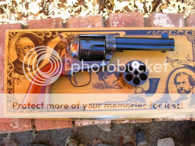

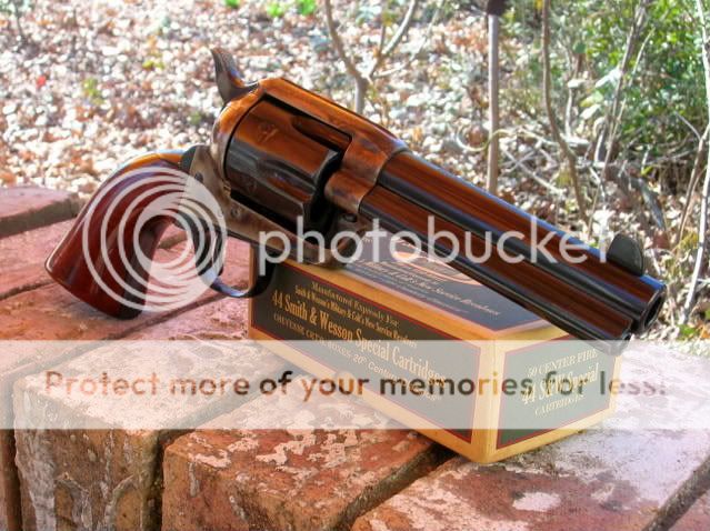

I've had this revolver for ~7 years and have shot it quite a lot. It's been very reliable and accurate for me. A Cimarron/Uberti is no Colt or Ruger, but I consider it to be a real bargain nonetheless. Lots of gun for the $$$. This is the only .44 Special Cimarron I've ever seen.
I found an unblued Uberti .44-40 cylinder for it and finished and fitted that so I can shoot those cartridges, too, if I wish. I have to load .430" bullets instead of .427" for best accuracy though.
