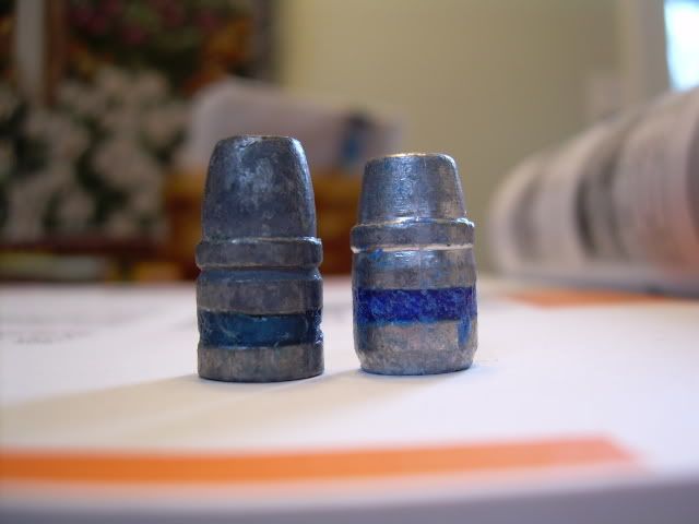

The next two loads are using some “off brand” lead bullets I found real cheap. I am saving the rest of my TVB’s for the good stuff. The one’s I have are of the 410549 mold variety. They are top heavy, or “cab forward” as I like to call them. There is less inside the case than the TVB design. Load data for these next two loads were found in the Lyman 47 manual.
220 grain LSWC, 10.0 grains Unique, PMC brass, CCI standard primers
Average = 1158, ES = 34, SD = 15.5
Good accuracy. Very stiff recoil. Definitely not like the Trailboss load. I like this load but I only have another 100 of these bullets and don’t plan on going looking for more. I will load the rest of them with this load.

Your points are well taken, Carl. I would like to further explain those last two loads. Below is a pic of the bullet used. The 215 grain TVB SWC is on the right. The bullet used for the above loads is on the left. 220 grains but with less bullet in the case.

Carl, In no way did I take your comments as negative. I posted the pics so that people could see the type of bullet used because I know that the Unique load, especially, is hotter than average for the other types of bullets where more of the base is inside the case.

And, it shows you're thinking it through. For instance, comparing the two bullets and how far they will go into the case is a good example.
That's one particular area I have seen that gives me doubts on a starting load. How to compensate for the seating depth. All I see are OAL stats; not seating depth.
By the way, that bullet on the left looks like a pretty good one. Should be accurate. Did you say you can't get more?

The slug on the left appears to be a pretty typical "Keith"-type SWC. It has been said that Mr. Elmer designed these to be front heavy ('cab-forward') for best performance on game and long range shooting ... I've always has good luck with this pattern of bullet accuracy wise in many calibers ranging from .357 to .45 Colt.
